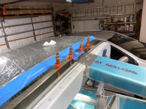

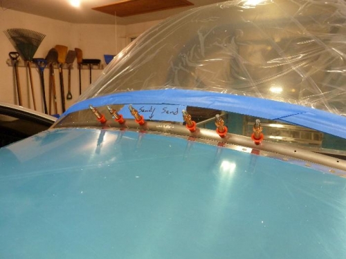

Brief Description:  file weld fillet on frame for fit, sand canopy for
Manual 34-05 step 3 filed weld fillet on the canopy frame for better fit, bend slightly the canopy frame angles, sanded existing corner cut out on the canopy for better fit. Pushed down on front of canopy to mark the tape on the frame. Did not adjust to back window because window is not in yet.
Manual 34-06 step 1 - partial 3 marked and drilled #40 holes in canopy frame front arch. Put canopy back on with help of Cheryl, then drilled the first few holes in the canopy front and aft arches.
first holes drilled in front

first holes drilled in aft
