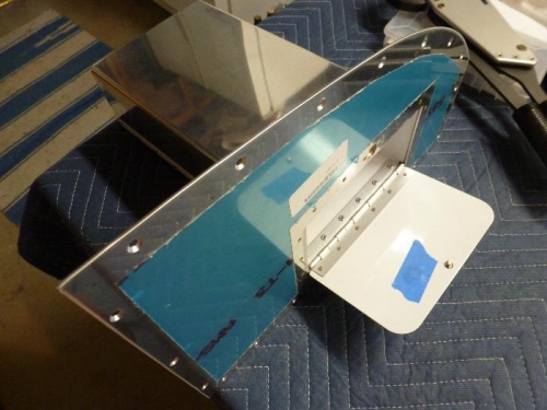

Brief Description:  assemble map box and rivet to right side panel
Manual 29A-08 steps 5 - 8, rivet map box halves, rivet door hinge to door and box, rivet map box assembly to right side panel. Note washer that holds door latch not installed (taped to door) for easier removal and painting of outside of door later.
Manual 29A-10 steps 2 & 3, screw right side panel to fuselage and drill #19 holes in map box bottom as well as forward fuselage bottom.
