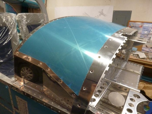

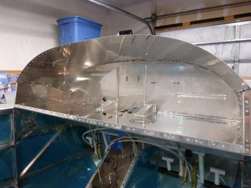

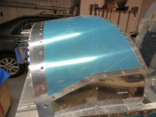

Manual 29A-06 steps 6 & 7, prep, drill, dimple, and deburr Upper Fwd Fuse skin F-1240. Test fit unto fuselage. Had to machine countersink holes in ribs to match #8 screw dimples on the cover. This was done due to no instructions to dimple earlier.
right side test fit
left side test fit
instrument panel side test fit
