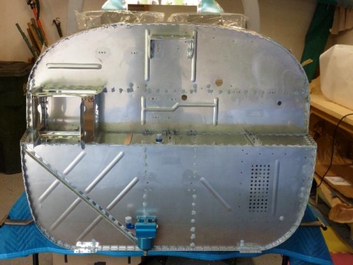

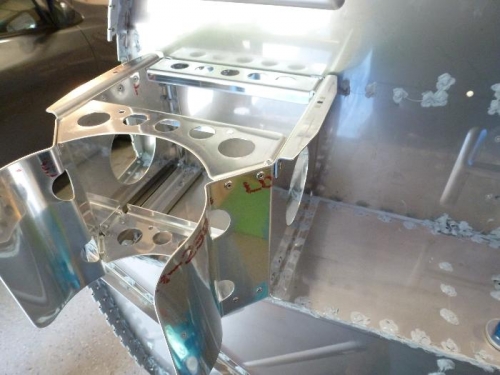

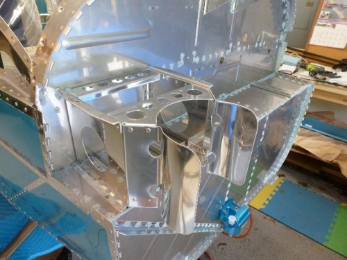

Manual 29A-06, deburr F-1201E-L & R, F-1201F, F-1201G. Steps 1 - 4, Assemble and attach battery/oil tank bracket to fuselage. Sealed all rivets on firewall with 3M 2000+ Firestop Silicone Sealant.
Battery/Oil tank mount
Firestop sealant on firewall
another view battery/oil mount
