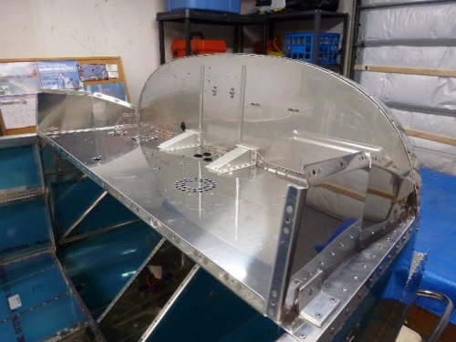

Manual 29A-03, apply 3M 2000+ Firestop silicone sealant around firewall. Used as caulking on joints.
Manual 29A-05 steps 7 - 11. Attach engine mounts, attach panel base and canopy ribs. used 3M 2000+ Firestop silicone sealant at the canopy ribs to panel base joint.
right side view panel base, ribs

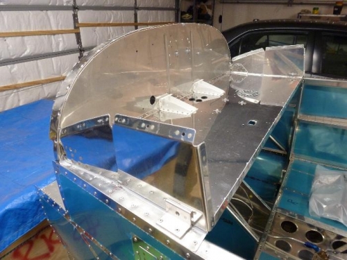

engine side view
engine side view

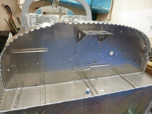

left side view panel base, ribs
