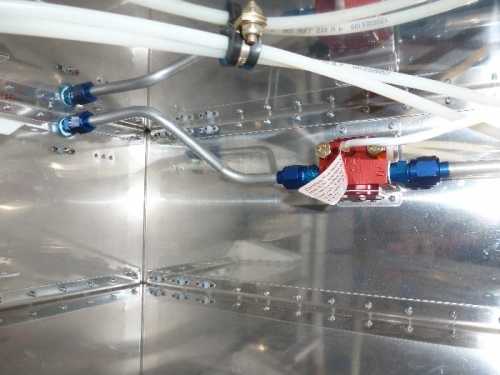

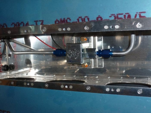

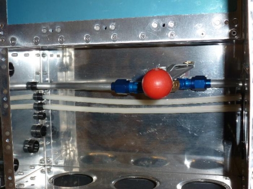

Manual 28-03 steps 1 - 4, 28-04 steps 1 - 5, 28-05 steps 4 & 5. Fabricated and installed all 3/8" fuel feed lines. Two of them were done before but I redid those with new tubing.
fuel lines at pump
fuel lines at fuel shut off switch
fuel lines, flow sender-gascolator
