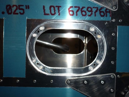

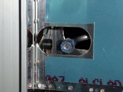

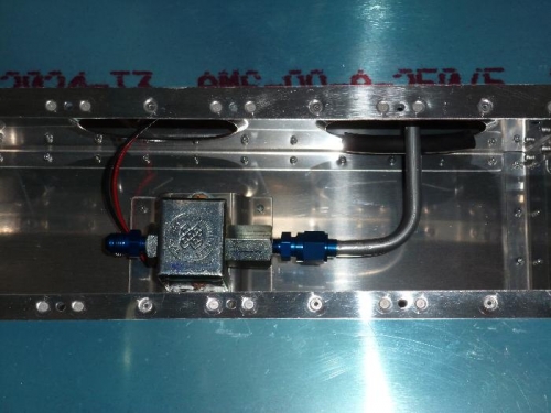

Brief Description:  fabricate and install first fuel line
Manual 28-03 steps 1 - 4, fabricate and install 3/8 fuel line from fuel pump to future tank. Used pipe bender and flare tools. Covered open fitting end that will connect to tank with "Cling wrap" to keep foreign objects out of line.
fuel line to fuel pump inlet
fitting for tank (tank not there)
bottom view to tank
bottom view to tank
