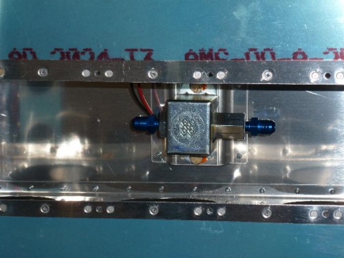

mount fuel pump and fuel shut off valve
Manual 28-02 steps 1 - 8, attach fittings in fuel pump and mount fuel pump. Torqued to 85 inlb.

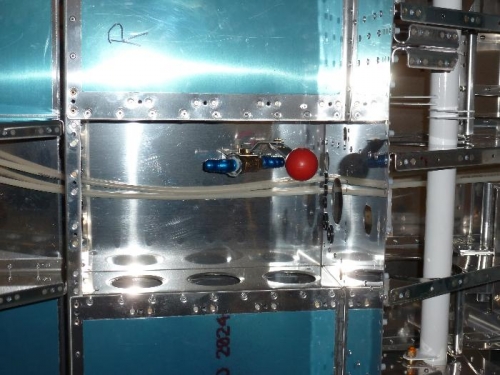

Attach fittings in fuel shut off valve and mount on bracket and rivet bracket to fuselage.
Used Loctite 567 on fittings.
fuel pump, flow forward
fuel shut off valve with knob
