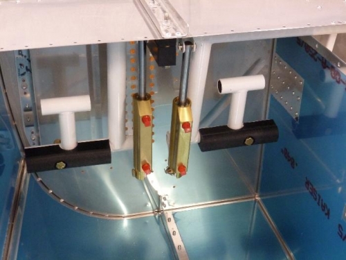

Brief Description:  mount rudder/brake pedal assembly to fuselage
Manual 27-03 steps 8 & 9, mount rudder/brake pedal assembly onto fuselage. Took some time due to close clearance. Ran to Home Depot to get some socket adapters and extensions which allowed some screws to more easily be tightened. Torqued all AN3 screws to 35 in/lb. Did not apply torque seal due to air temp today in the garage.
right side rudder/brake pedals

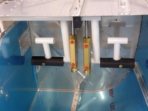

pilot side rudder/brake pedals

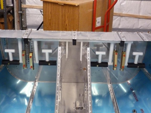

both sides rudder/brake pedals
