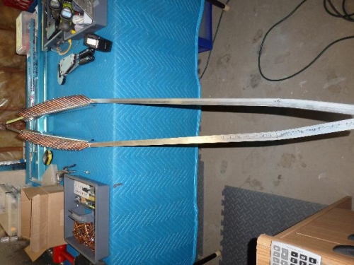

Manual 23-02, step 6, bend and drill and cleco longerons.
Used longeron bend dies I borrowed from Scott Malcomb of "Eagles Nest" (see www.EaglesNestProjects.org). These dies originally came from Avery Aircraft Supply. I paid shipping both ways to/from Scott.

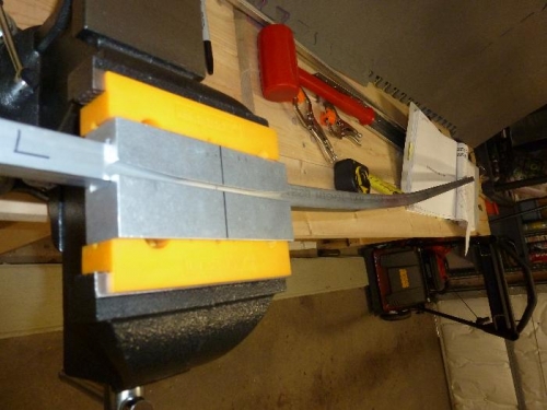

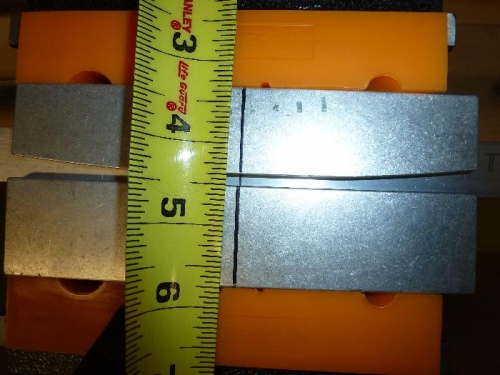

The dies work extremely well and are easy to use. No beating with a hammer was required during the major bend. I used a newly purchased 6" bench vise with magnetically applied jaw pads (orange). I started with the center mark on the die place at the bend start mark. Squeezing the die to about a 1/8" space on the die (see picture 1) seemed to work well at 1" intervals to get the curve about right. I had to repeat the bends after checking once or twice. By hand I bent the longerons to make the top face flat and then recheck bend and redo as needed. I also used the die for the aft end bend with the die at the bend mark line and not moved. I squeezed the die and checked the bend repeatedly. I did use a plastic mallet with the longeron still in the die to make the final bend angle.
I clamped a strip of scrap .025 aluminum skin on the side of the longeron as I clamped and match drilled holes in the longerons. Drilled 3 to 4 holes at once clecoing each before drilling the next.
bend die squeezed to 1/8
bend die squeezed to 1/8"
longerons bent
longerons bent
longerons drilled and clecoed
