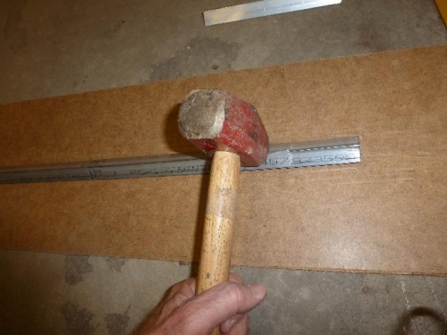

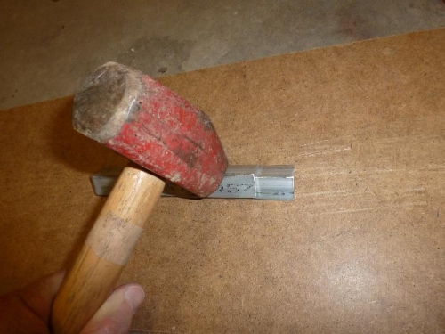

Watched the homebuilthelp.com DVD and texted Scott Malcolm for suggestions. Used the DVD suggestion of using a heavy hammer with piece of extra longeron material cut off on top of the longeron corner to keep from marring them too much. This worked. See pictures.
Used a piece of masonite on the cement floor for flattening. This kept them from being marred by the floor. Masonite does not compress so works well.
