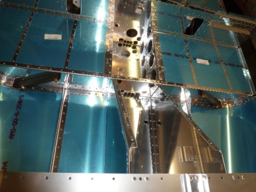

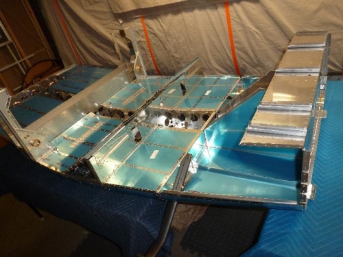

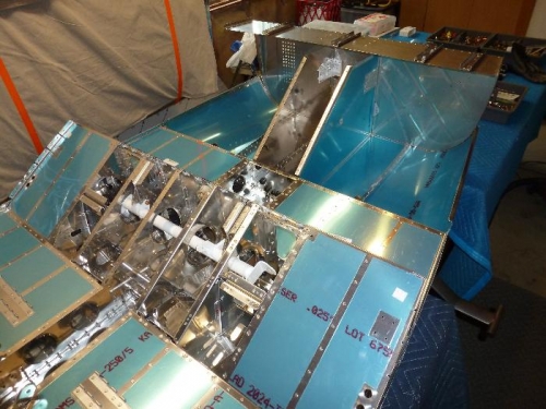

Manual 22-05 step 1, Cheryl helped hold and position forward fuselage while I clecoed. Riveted the two together. Had to remove both steps temporarilly to fit two rivets near the steps. Reattached and torqued to 60 in-lbs and applied torque seal.
view from right side
view from above
view from above
view from right rear
