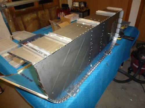

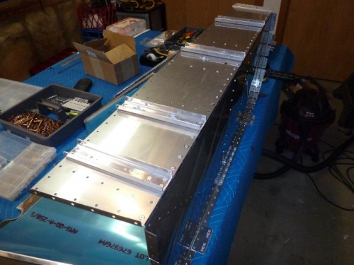

Install firewall shelf
Manual 22-03 steps 2 - 5, deburr F-1201B, dimple and rivet nut plates onto F-1257 rudder pedal support channels and onto F-1201B firewall shelf. Apply fuel tank sealant and rivet the firewal shelf to the forward fuselage assembly.
view from right side
view from front right side
