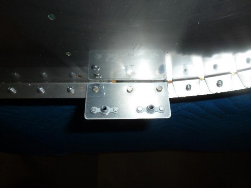

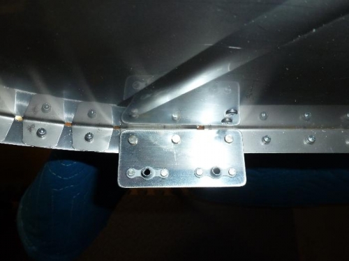

rivet cowl attach plates, drill gascolator hole
Manual 22-02 step 12 finish, steps 13 & 14. Rivet cowl attach plates to fuselage, drill out gascolator hole (had to file enlarge and be sure there is enough clearance to gascolator fitting). Rivet CS4-4 on engine mount.
Manual 22-03 step 1, separate and deburr F-1257.
left cowl attach plate
right cowl attach plate
