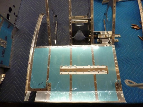

finish left seat floor assembly
Manual 21-06 step 9, deburr seat hinges, 21-07 step 1, deburr F-1225-L & R seat floors.
Manual 21-07 steps 1 - 4, 6 - 9, rivet seat hinges to seat floors, rivet left seat floor to left seat rib and seat rib assembly. Rivet various nut plates and seat floor support. Install snap bushings.
finished left seat floor assembly
