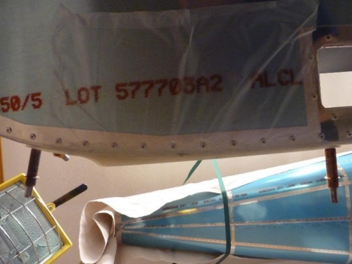

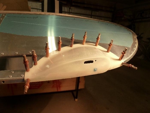

Manual 40-08 steps 3 - 6. First tested the epoxy and flox mixture. Worked well. Apply epoxy/flox mixture in fiberglass light mount. Applied self sicking plastic wrap to the wing wher the mount with epoxy/flox will interface. Did this to avoid car wax on the wing pieces from going into cracks and holes and difficult to clean out. Applieg wax to the plastic wrap to keep the epoxy/flox from sticking. Worked very well. Used wall hanging putty (blue in the picture) to fill-in the nut area as required.
Checked hardware for wing tip light mounting.
epoxy/flox setting up
edge view
edge view
