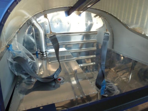

Manual 33-03 step 2 installed the shoulder harnesses, torqued the bolts and applied torque seal.

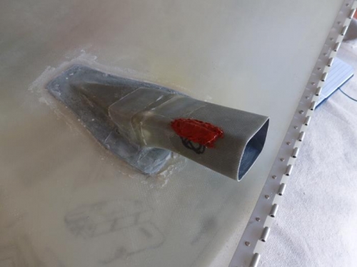

Manual 46-20 step 7 checked the voltage regulator intake scoop clearance with throttle cable. Applied RTV on the scoop to avoid abrasive action due to contact.
