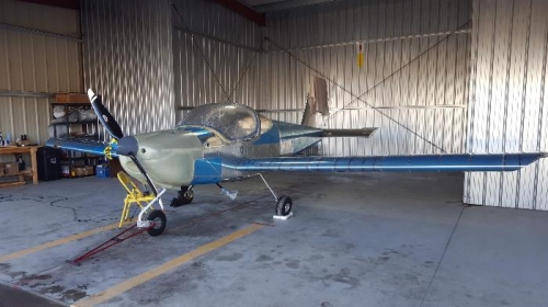

Manual 30-02 step 7, install the left wing with the help of Eldon Cross, Mike Dunn, and Mike's friend Steve. Greg watched for proper alignment of connectros, etc. Greg also placed the spar pin. Spar pin and mating holes had a small amount of grease applied. The left spar pin had to be knocked into place with tapping using a board and hammer. Before that an exhaust pipe spreader was used to better align the parts. It went in rather smoothly.
Manual 30-03 steps 1- 3, install right wing. It went in very smoothly. Spar pins all set.
Will need to trim the flaperon skins next to the fuselage. Lights all work perfectly, nav, strobes, landing solid and pulsing. Stall warning was stuck on but I readjusted to correct. Now works great.
Worked on the CO monitor connections. Investigated the wiring schematics to verify the correcvt connections have been made. It all seems correct. I installed the Aithre app on the iPad but it did not connect via bluetooth so further investigation is needed.
