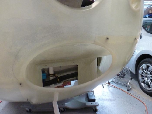

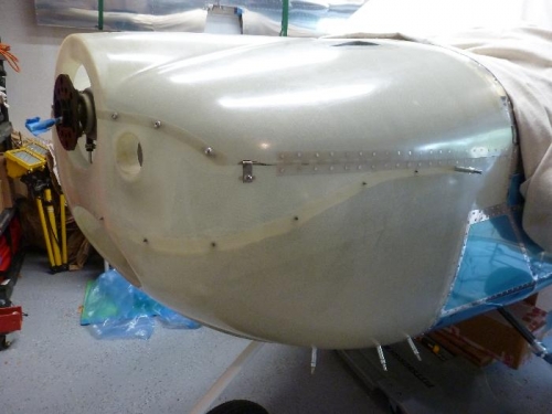

Manual 49-14 steps 2 - 9, prepped for ready to epoxy, cut fiberglass strips. Epoxy the interface to the duct, duct to the bottom cowl, apply fiberglass in three places. Cheryl helped hold the duct so the interface could be more easily attached. Did not attach the oil cooler to make it easier to man-handle the cowl and duct.
Installed bottom and top cowls with all hardware to allow to cure overnight.
cowls in place, epoxy setting
view inside the cowl
