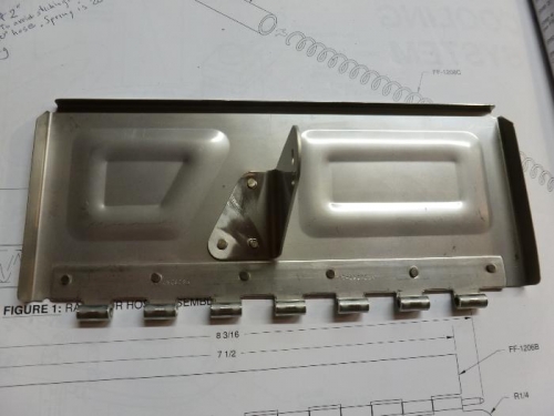

Brief Description:  rivet colling box hinge and bracket to door
Manual 49-03 steps 5 & 6, rivet hinge to the cooling box door with SS rivets as called out. Rivet the cooling door bracket to the door with aluminum rivets due to difficulty in squeezing SS ones at all.
hinge and bracket on door
