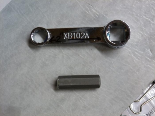

Manual 46-05 step 8, reinstall the ignition mount screw per instructions. Torqued to 55 in-lbs and applied Loctite 242 per Rotax heavy maintenance manual section 74-00-00.

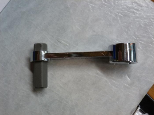

Modified a 8 mm hex wrench to be used with torque extender so can torque one difficult to reach engine mount bolt. See 46-05.
