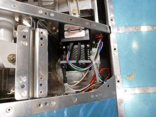

Brief Description:  install pitch servo, drill hole for AP stop switch

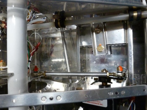

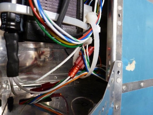

Manual 44A-04 steps 2 - 6 install the pitch servo, electrical filter, wiring etc. Torqued the pushrod to 30 in/lbs attached to the flaperon controls. Applied torque seal.
Manual 44A-05 step 2 drill to 1/2" the mounting hole for the Autopilot cutoff switch. Will install and connect the switch when the rest of the avionics are installed.
pitch servo installed
pitch pushrod detail
wiring detail
wiring detail
