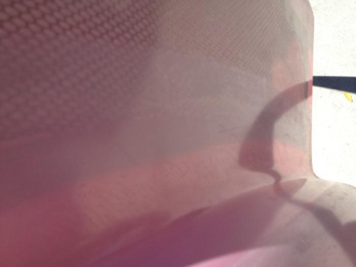

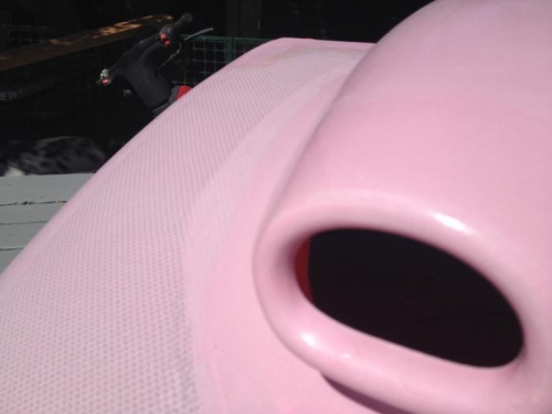

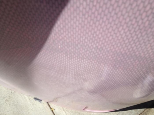

Brief Description:  what they call a fiberglass cowl
The carbon honeycomb show thru the glass, thousands of pin holes and crack where they joint the parts. Not happy, love the rv's but this is .............. junk. i would pay more for the cowl if they were GOOD, no pin holes.You have to put a wet coat of epoxy on the inside to seal the honeycomb. They say that these are lighter than the other way they use to make them, not correct! my buddy had a old layup type, i wieght both. My cowl was 3 lbs heavier. tell us like it is, this way is faster and they make more money.
