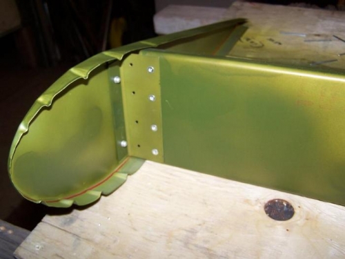

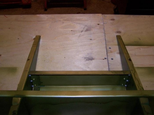

Manual Reference:  Elevator section 1
Brief Description:  Frame Complete
I completed the construction of the elevator frame with the placement of the center bracket in accordance with the construction manual. I also opened the remaining holes to 5/32 and riveted with A5 pull rivets supplied by the manufacturer. First two rivets were installed by my wonderful girlfriend, Kristin; I did the rest. I also applied more corrosion protection to the bare surfaces and prepped the frame for skin installation.
L-bracket placement

Center bracket
Center bracket

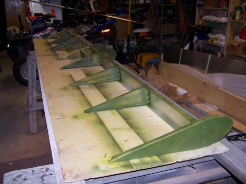

Completed elevator frame
