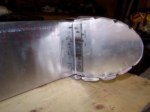

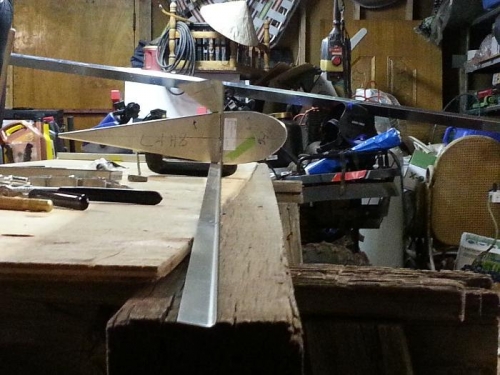

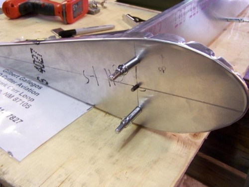

Continued with the rib placement: Set the position of the end ribs, elevator hinge pin and L-bracket that attaches it to the elevator spar. Also finished the center nose rib(s) placement and primer application of the aft ribs.
End rib, with L-bracket and hinge pin
Elevator hinge pin correctly placed
Center nose rib correctly aligned
