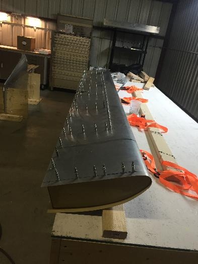

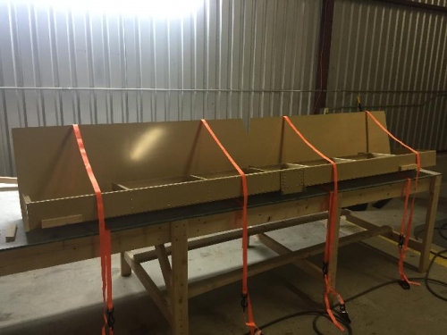

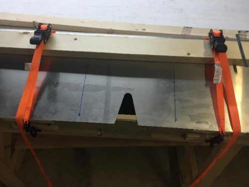

Wrapped horizontal stabilizer skin around leading edge over the top of the hz. stab. Locate and lay out rivet lines. Drill skin to skeleton.
Wrapping the hz. stab. skin
Laying out rivet lines
Top of skin cleco'd to hz. stab.
