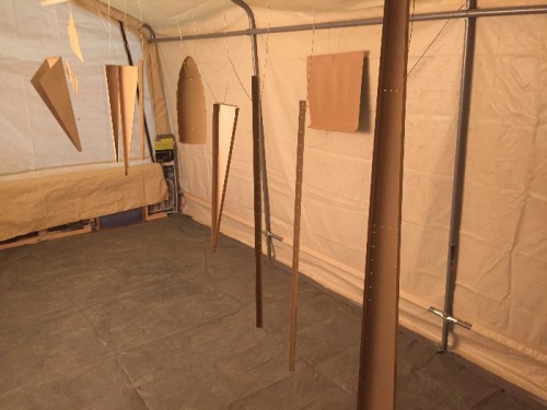

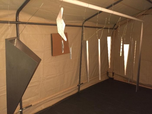

Disassembled rudder skeleton. Deburred all the holes and edges. Cleaned, scuffed, and cleaned parts again. Sprayed with self-etching wash primer, followed by top primer.
prepped and ready
Primed. Now time to dry.
