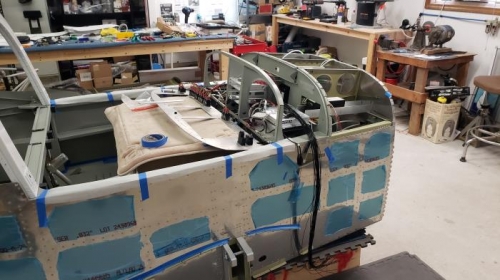

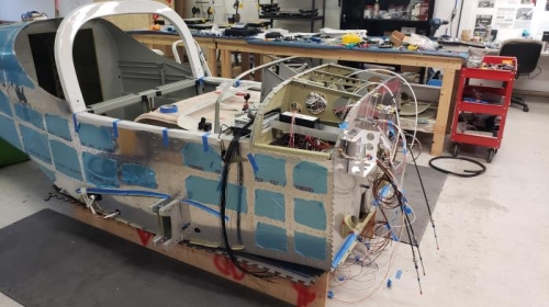

Brief Description:  antennas
Put both ends on the transponder coax, put riight angle BNC on Comm2. Routed ground lines under the radio stack. Checked CAN BUS at both ends, yaw servo needed a jumper pins 3 & 4 to terminate. Roll servo already had one. Put in parts for Power Module (circuit breaker panel). It doesn't fit in there very well, looks like it could short to airframe so I'll make some modifications.
