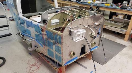

Brief Description:  instrument panel
Tie-wrapped main Stein panel harness up at center, figured out reaches to all areas, drilled for GD40 CO detector. Opened roll of loose wire (17 of them) and started to figure out where they all go. Opened the engine box and confirmed that Slick mag is on the left and the P-Mag is on the right side of the engine.
