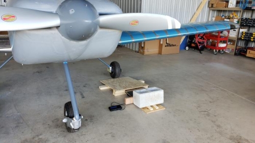

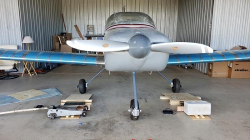

With help from Lori and Al we did an "empty" weight and balance for the plane. Cleaned the work area first then installed cowl, spinner, gear fairings, full interior, all screws. Weighed the plane 3 times, moving the scales each time. Concensus result is:
Weight: 1274 lbs CG: 80.52
Left wheel weight/arm: 437.4/97.375 Right wheel weight/arm: 441.8/97.25 Nose wheel weght/arm: 394.8/43.125
