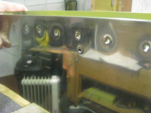

Primed rest of the parts. Dimpled all of the skeleton and skins for both rudder and horizontal stabilizers.

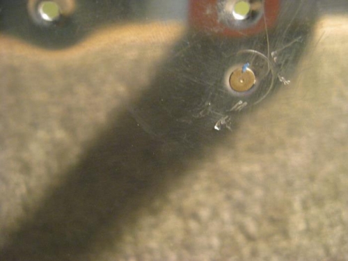

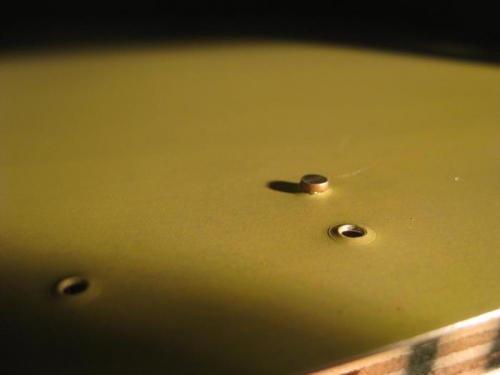

Accidently put an extra hole in the skin while dimpling. Dumb mistake because I was balancing things instead of setting the work in a stable configuration. Fortunately it's on the bottom or the skin. I deburred it and put a 3-3 rivet in and nobody will ever know the difference.
Very frustrating but oddly satisfying to fix.
OOPS! Squeezer slipped and got a bonus hole
No big deal, debur, finish dimple, drive a 3-3 rivet
No worse for the wear.
