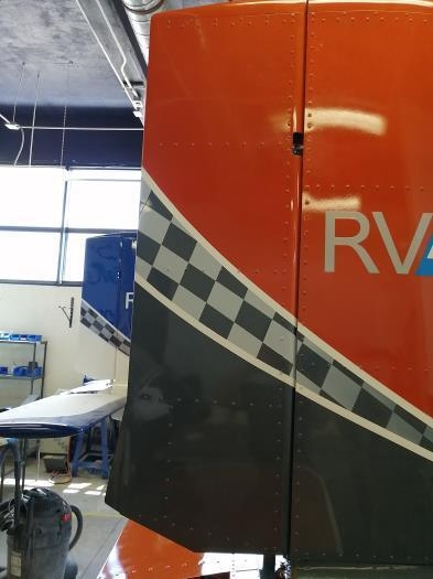

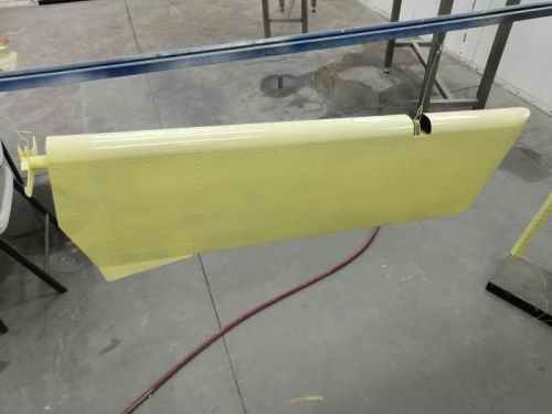

A surface pretreatment (Prekote) was applied to Rudder. Then Primer was applied to Rudder.
6/12/20 2.5 Hrs
Top coat (White Color) was applied to the Rudder to trace the strip.
7/14/20 4 Hrs
Top coat (Grey Color) was applied to the Rudder to paint the dark squares and bottom color.
7/15/20 3.3 Hrs
Top coat (Orange Color) was applied to the Rudder.
7/16/20 5 Hrs
Top coat (Grayish Color) was applied to the remaining squares of the Rudder strip.
