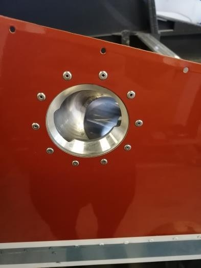

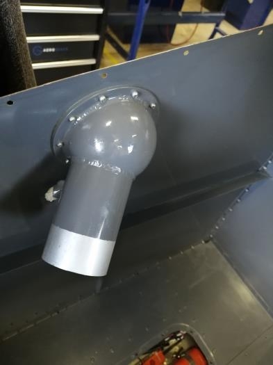

3: The filler neck T-01231 was riveted to F-01277-R-1
10/10/2020 8.5Hrs
2. The fuel tank was temporarily installed.
4. The T-00007A fuel cap was inserted into the T-01231.
5. T-01235 overflow fueol line was fabricated by making two bends, sliding on the fluid fittings and flarig the end of the tube.
6. The indicated snap bushing was inserted into the hole in the F-01273-R-1. The fuel line was routed through the hole in the F-01273-R-1. The fuel line was looserly attached.
7. The bottom of the ful line was marked, then, the fuel line was removed and the mark was cut.
8. The T-01236 fuel overflow sleeve was fabricated by cutting a1''piece of tubbing.
9. The fuel line was repotitioned with the end extending beyond the bottom of the fuselage a couple of inches. Then, it was slipped on the T-01236 high enough toclear the bevel.
