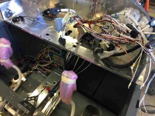

1: AV-60000 was installed onto F-01246 and the harness was routed up and forward through the avionics bay.
2: Fuel pump 1 and 2 connector were connected to the ones on the harness.
3: K7562 (ground spade connector) was installed to the firewall.

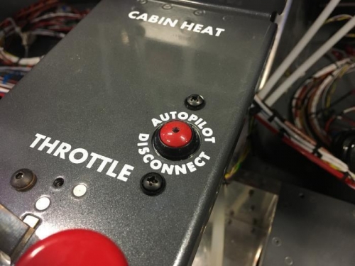

5: The autopilot disconnect button was installed on F-01246.

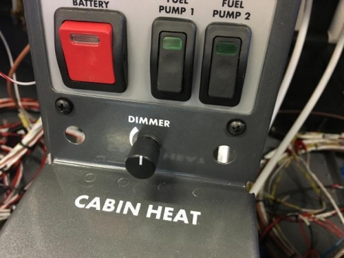

6: ES-00195 dimmer was installed onto F-01246, the shaft was indeed trimmed to allow the dimmer itself to be as flush as possible to the center console.
03/12/20: 1.73Hrs
Worked on step 4.
03/17/20: 0.28Hrs
4: The SA-1018 pins on WH-P30-1 were inserted into the existing D-sub on the garmin harness, then it was reconnected to the AV-60000.
07/09/20 0.18Hrs
7: The XPNDR coax cable was connected to the AV-00012.
