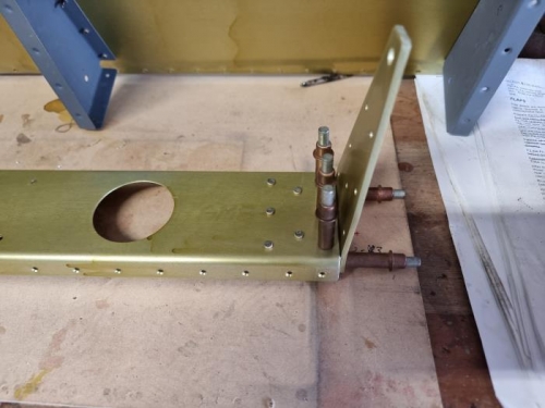

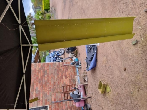

Brief Description:  Right flap prep & priming, starting left flap rive
-Removed vinyl and hole deburred right flap
-Edge deburred right flap
-Removed small amounts off edge/around hole corrosion
-Dimpled
-Primed all remaining bits, came up much better than last time, must not have been thouroughly mixed last time.

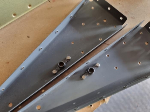

-Clecoed 706a/b to spar and riveted to spar
-Drilled & riveted rod end nuutplated to both side inboard ribs
-Started riveting ribs to skin
