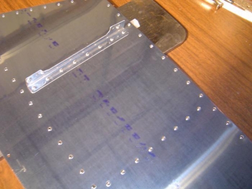

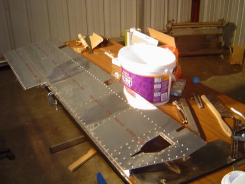

Brief Description:  Riveting the top skin and the skins together
Riveted the top rib halves to the top skin. Marked the bonding area for the foam TE ribs and masked around them with tape before scuffing the skins. Assembled the skins and match-drilled the inboard TE end of the new skin and then dimpled the holes before reassimbling the skins and clecoing the ribs together. I then riveted the ribs together and also riveted the tip rib to the front spar. Next I installed the front spar and riveted it to the ribs. Finally, I clecoed the skins to the front spar to be ready to do the riveting the next session.
Rivet count: 303 Total: 3334
