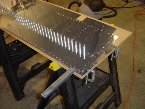

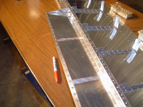

Brief Description:  Continue riveting left elevator

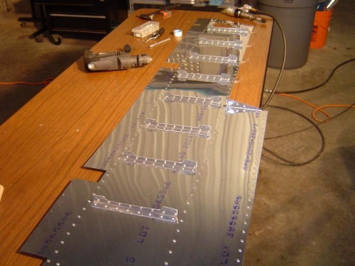

Riveted the remaining rib halves to the bottom left elevator skin. Removed the plastic from the upper left elevator skin and dimpled the rib halves before riveting them to the skin. Clecoed the rear spar to the upper skin and riveted it to the ribs, along with the shear clips and gusset on the inner end. Scuffed the trailing edge and where the TE ribs will be glued. Riveted the rear spar to the top skin, except where the trim tab hinge will go. I put the two skins together by clecoing the rib halves together and the bottom skin to the rear spar. As in the third picture below, I riveted the rear spar to the bottom skin using the modified bucking bar. The rest of the spar was riveted by using a squeezer.
