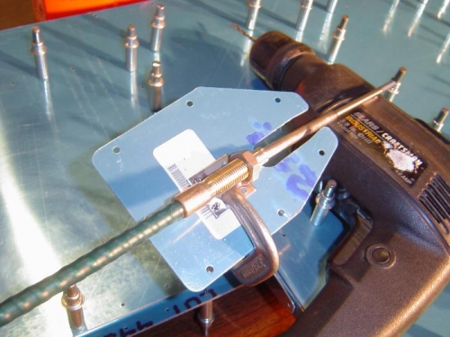

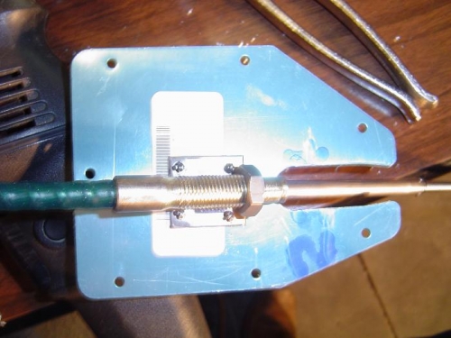

Brief Description:  Final assembly, match drilling elevator
