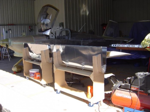

Brief Description:  finished disassembly, prepped the new skins
