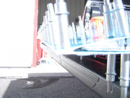

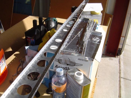

Brief Description:  Final drill skins, diaassemble, debur, and dimple
Drilled skins to skeleton and trailing edge. Removed and marked skins and used roller to put slight bend in trailing edges of the skins. Disassembled the skeleton and deburred all the holes. Dimpled all the holes in common with the skins.
