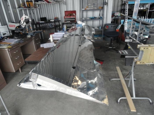

Brief Description:  Install elevators on HS

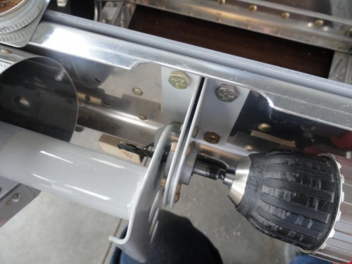

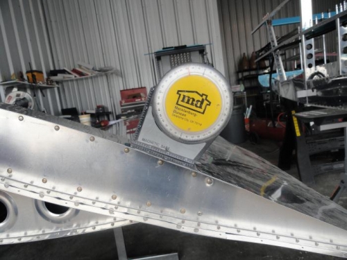

Attached the HS to the worktable according to the instructions and installed the rod end bearings into the elevators. Installed the left elevator and measured the travel. I had to remove a little material at the bottom spar web to get full elevator down. I then filed the drill bushing while it was in a drill press until it would fit the center bushing and then drilled the left elevator horn. Next I fitted the right elevator (it got full travel without adjustment), and drilled it's horn. With both elevators installed and taped in trail position, I marked the aft-most horn for the pushrod bearing hole and drilled it and a block of wood as a drill guide. I then drilled the other horn using the guide I had made. I inserted a bolt through the horns and tested the travel of the combined elevators, to make sure I had not created an interference. Not to worry, everything was fine. Covered the parts with bubble wrap to await the next session.
