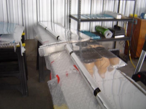

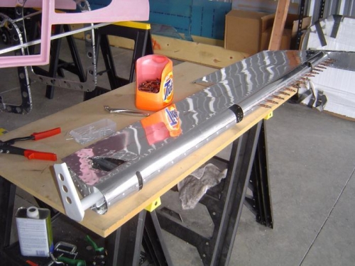

Brief Description:  Finish riveting right elevator
Riveted the trailing edge of the right elevator and then finished the tip rib rivets and the inboard shear clip. Next, rolled the leading edges and clecoed them together before riveting them. Finally, shaped the counterweights and fastened them to the tip rib.
Rivet count: 68 Total: 3780
