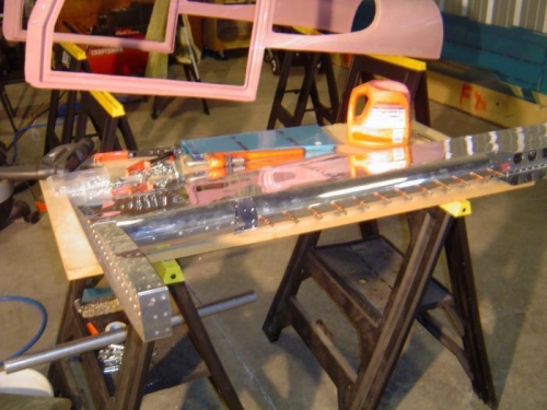

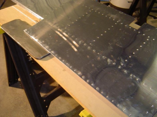

Trimmed excess proseal from trailing edge and cleaned it from the dimples. Back-riveted the trailing edge. Riveted the tip rib and the inboard overlap. Rolled tip and middle sections of the leading edge and riveted the tip section.
Rivet count: 44 Total: 3542
