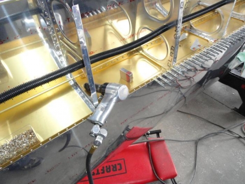

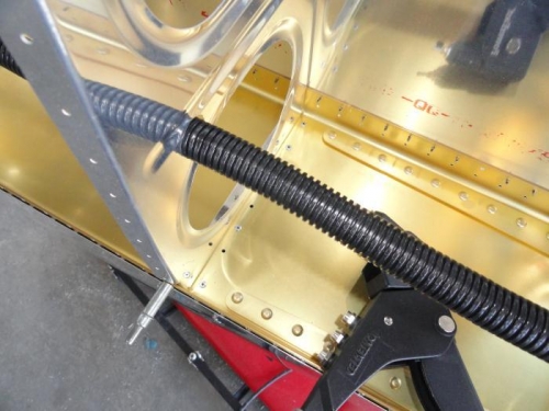

I finished drilling out the tie-down hole and then removed the leading edge and dimpled the aft line of rivets top and bottom. I then replaced the leading edge on the spar and riveted the ribs to the spar. I opted to use the optional LP-4 rivets on the two outboard ribs. I then riveted the aft line of rivets on the bottom side; I will do the top when I finish riveting the top skins.

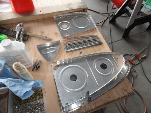

Next I turned to the left fuel tank. I fluted and straightened all the ribs. Then I cut all the stiffeners apart and spent some time cleaning up the edges of the stiffeners and a clip. All blue plastic was removed as I worked.
