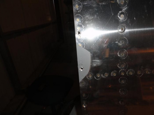

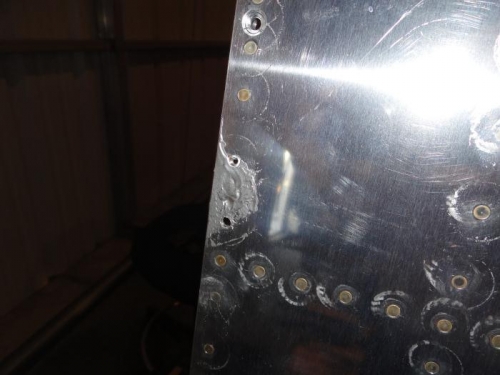

Brief Description:  riveting the left top wing skin
Judith showed up and helped me with the skin riveting. She drove and I bucked. She stayed long enough to drive most of the inboard skin. After she left, I did the end rib. I found on re-reading the plans that I had mis-drilled one of the nutplates so I had to fill the countersink with aluminum filler and then re-untildrill and countersink again. When the filler had set, I riveted the nutplate in place and primed where I had sanded the filler down.
