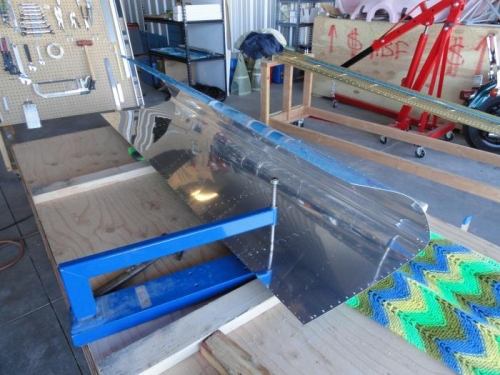

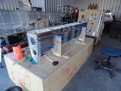

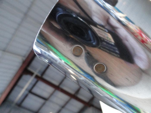

With that task out of the way, I turned to the leading edge. I match-drilled all the ribs and the J-stiffener. When I was done, I drilled the screw holes in the splice plate to #19 and countersunk the holes for the nutplate rivets. Then I disassembled the whole thing and dimpled everything except the back row, top and bottom, which can be done with a squeezer after I am sure of the fit to the spar. Then I primed the splice plate, removed the plastic from the skin, and filled the two holes for the stall horn slot with rivets. When the primer dried, I riveted the K1100 nutplates to the splice strip and then clecoed everything back together. Now we are ready to rivet.
