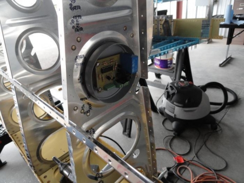

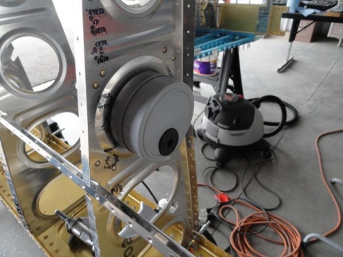

Manual Reference:  16-2.5 & 6
Brief Description:  Dimpling left wing skins for riveting
Dimpled the rest of the wing skeleton. While I was at it, I riveted the pitot heat mount to the rib and then installed the control. The first two pictures show the mount and the cover. I also dimpled the outboard J-stringer.and set it into position.
