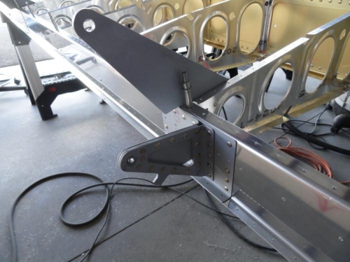

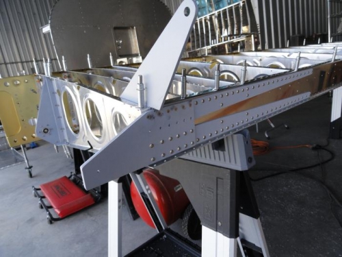

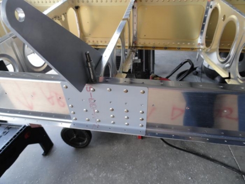

Riveted rear spar together and to ribs
Riveted the left rear spar per the rivet callouts. Added the inboard aileron hinge bracket and reamed the 3/8" holes in the flap hinge supports.
