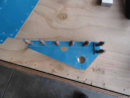

Cut the angle and spacer pieces for the 1010 ribs for both wings. Drilled the spacers to their respective bellcrank parts and then assembled the bellcrank halves with the VA-146 bearings. Added the assemblies to their respective ribs, clamped the angle pieces, and drilled them in place. Then match-drilled the rest of the assembly. Added the flap hinge support and 1025B to both ribs but have not match-drilled yet. Also added the same parts to W-1011 ribs to make four assemblies, two left and two right. Set the ribs for both wings aside to be finished later. Trimmed the forward tabs on a W-1011R and trimmed the aft flange of a W-1012R. Clecoed all the ribs to the left spar except for the three ribs with the flap hinge support, which still need to be match drilled.
