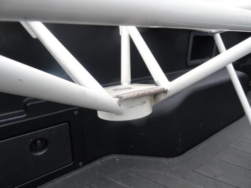

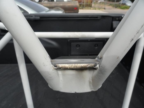

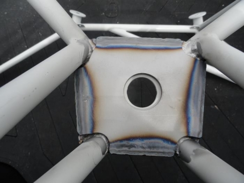

Manual Reference:  SB 14-8-29
Brief Description:  Compliance with service bulletin
A couple of weeks ago I removed the nose gear assembly from the engine mount and took it and the doubler plate to a local welder with instructions to weld the plate in place around the perimeter. This will be sufficient to prevent the plate from moving laterally and damaging the engine mount tubes. The mount was then taken to Iron Horse Powdercoating to be redone (preventing corrosion ). Afterward, the modified mount will be reinstalled on the airframe.
